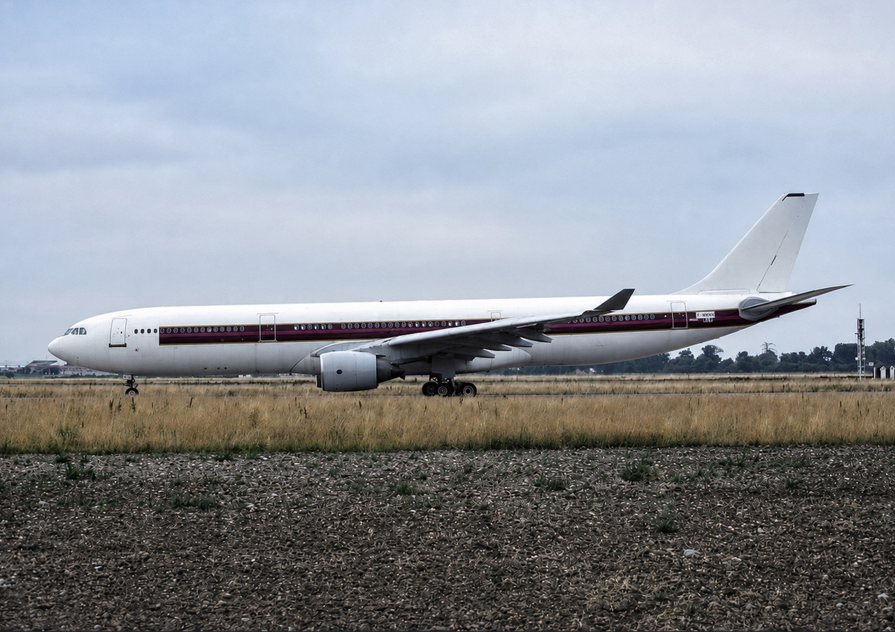

Photo (c) via Werner Fischdick - Toulouse-Blagnac Airport (TLS) - Juin 1994
