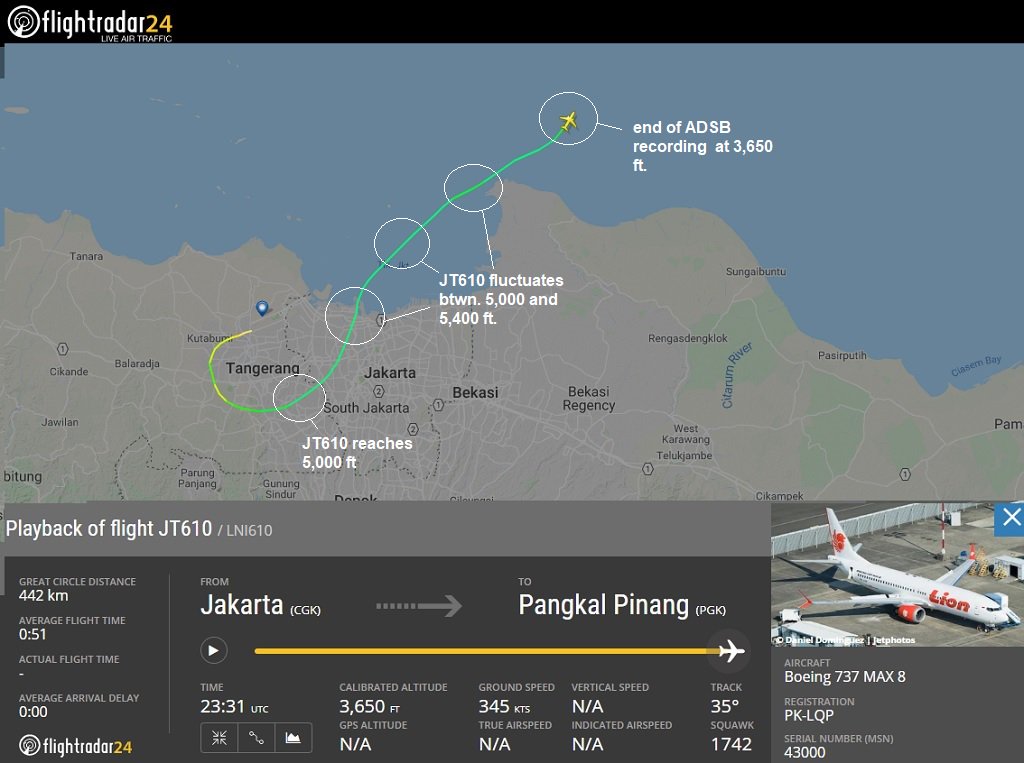

Preliminary data from Flightradar24 shows the plane went through a sharp drive towards the sea, according to Reuters.
“The aircraft climbed to around 5,000 feet (1,524 m) before losing, and then regaining, height, before finally falling towards the sea. It was last recorded at 3,650 feet (1,113 m) and its speed had risen to 345 knots,” the agency reported.

Des détails sur le profil du vol.
https://www.flightradar24.com/blog/flig ... ght-jt610/
